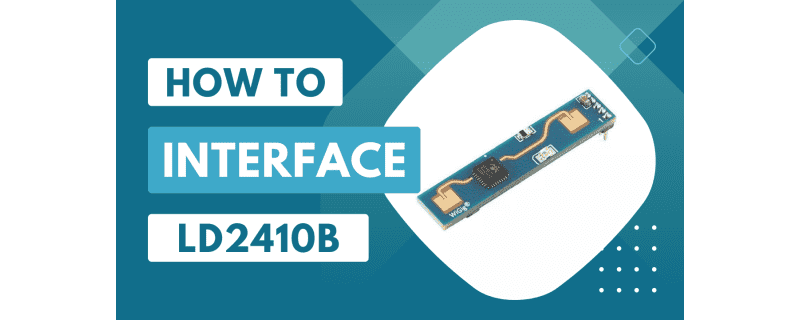

Introduction:
In this tutorial, we will explore the process of interfacing the LD2410B sensor with a USB-UART converter, enabling communication between the sensor and a computer or smartphone.
The LD2410B sensor is a versatile and powerful device used in various applications, including distance measurement, obstacle detection, and motion tracking. We will cover two methods to achieve this: using the LD2410 Tool app on Windows and the HLKRadarTool app on a phone.
