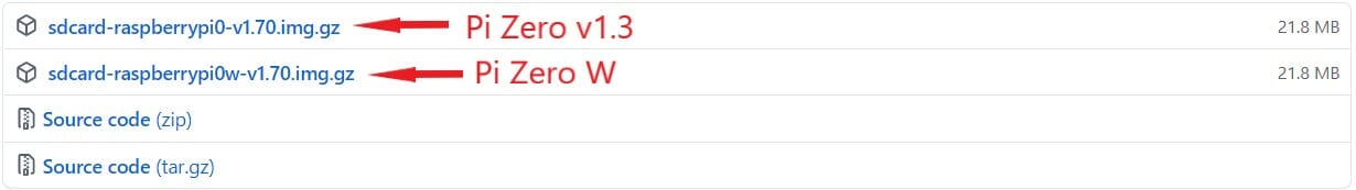

First thing first, we have to prepare the SD card for the Pi Zero. Go ahead and download the latest release of the image file for this project.
Depending on which Pi Zero you are using, the file you download should have a ".img" extension.

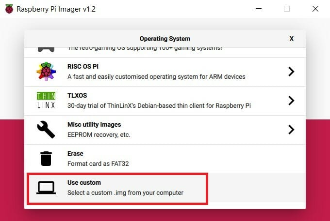

On the Raspberry Pi Imager, click on "Choose OS". Then scroll down to the bottom and select "Use custom" as shown in the image below:

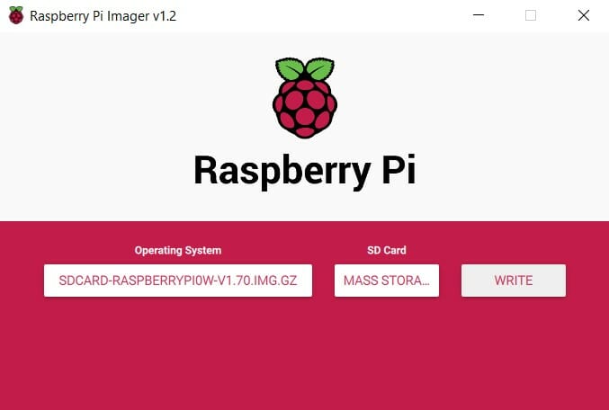

Search for the image file that you have downloaded previously and click "Open". Next, choose the destination SD card and click "Write" to start flashing. That should take only a few seconds to complete thanks to the extremely small image file size.

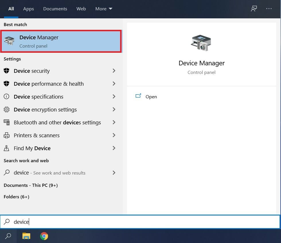

You can search for the COM port of the Pi Zero from the Device Manager. Right click on the Windows icon of your PC and select Device Manager.
Alternatively, you can search for the application by using the Windows search tool.

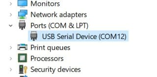

Then, look for "Ports (COM & LPT)". Click to expand it, you should be able to see the COM port number of the Pi Zero (in this case it is COM12).

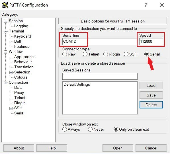

Now launch the Putty application you downloaded earlier. Under the "Session" category, select the "Connection type" as Serial. Enter the COM port number in the Serial line and set the Speed (baud rate) to 112800.
Click "Open" to start the connection with Pi Zero. Use the username and password as root to log in. Once you have log in to the Pi Zero, enter the following command to use the camera settings:
